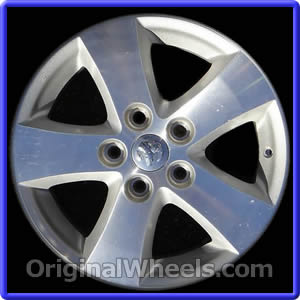

Hi Frogbox. Thank you for the info on doing this upgrade. I just recently bought a 2010 DJ SXT with factory 17" wheels. It had new rotors and pads on it when I got it but there are already signs of the rotors warping. I plan on doing the front upgrade sometime in the near future and this article will be priceless!
I was looking at the clearance between my current calipers and the factory rims and I am concerned that there will not be enough clearance for the bigger brakes. I read where the rims need to be 17" or larger. Seems like most have the 19" rims. Has anyone completed this upgrade with the stock 17" rims? Here are the rims I have:
Thanks!
Stock 17's will fit. The clearance between the wheel and the larger brakes is minimal... Looking at it, one would wonder why they even bothered with 17's.
