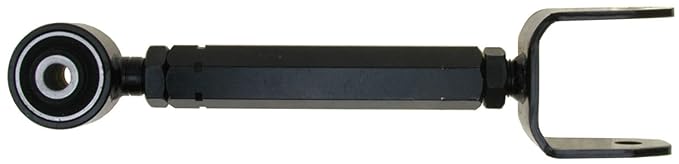

i am getting close to 100 k and my local dealership quoted me plugs $89 for 6 plugs labor $210. coolant flush $179 and didnt quote me for a transmission service but my lat one that i did at 60 k was about $180 plus tax on all.... also.... yes the upper rear control arms are NON adjustable the lower ones are adj as is the whole front end is adj as well. i know this as my upper rear were bad and i had them replaced with aftermarket adj control arms about $80 for 2 plus install about $150 also 4 wheel alignment cost about $95. most places i bought a lifetime deal from quick lane (they are owned by ford dealers)cost me $172  every time i have my oil changed and tires rotated at 6 k i have the alignment checked   USA prices and also i would skip the fuel induction service unless you are having problems , i run some chevron fuel inj cleaner thur my tank about 2 times a yr

see my above post yes your upper rear control arms are out of spec (camber) NON adjustable you can just replacing them with oem parts but do like i did with aftermarket adj ones way better

  • ACDelco 45K0225 Professional Rear Upper Suspension Control Arm
Click image to open expanded view
by ACDelco
Price: $90.43 & FREE Shipping. Details  can be found cheaper this is amazon
 i paid about $160 for both sides from quick lane they gave me a lifetime warranty on the parts as well
