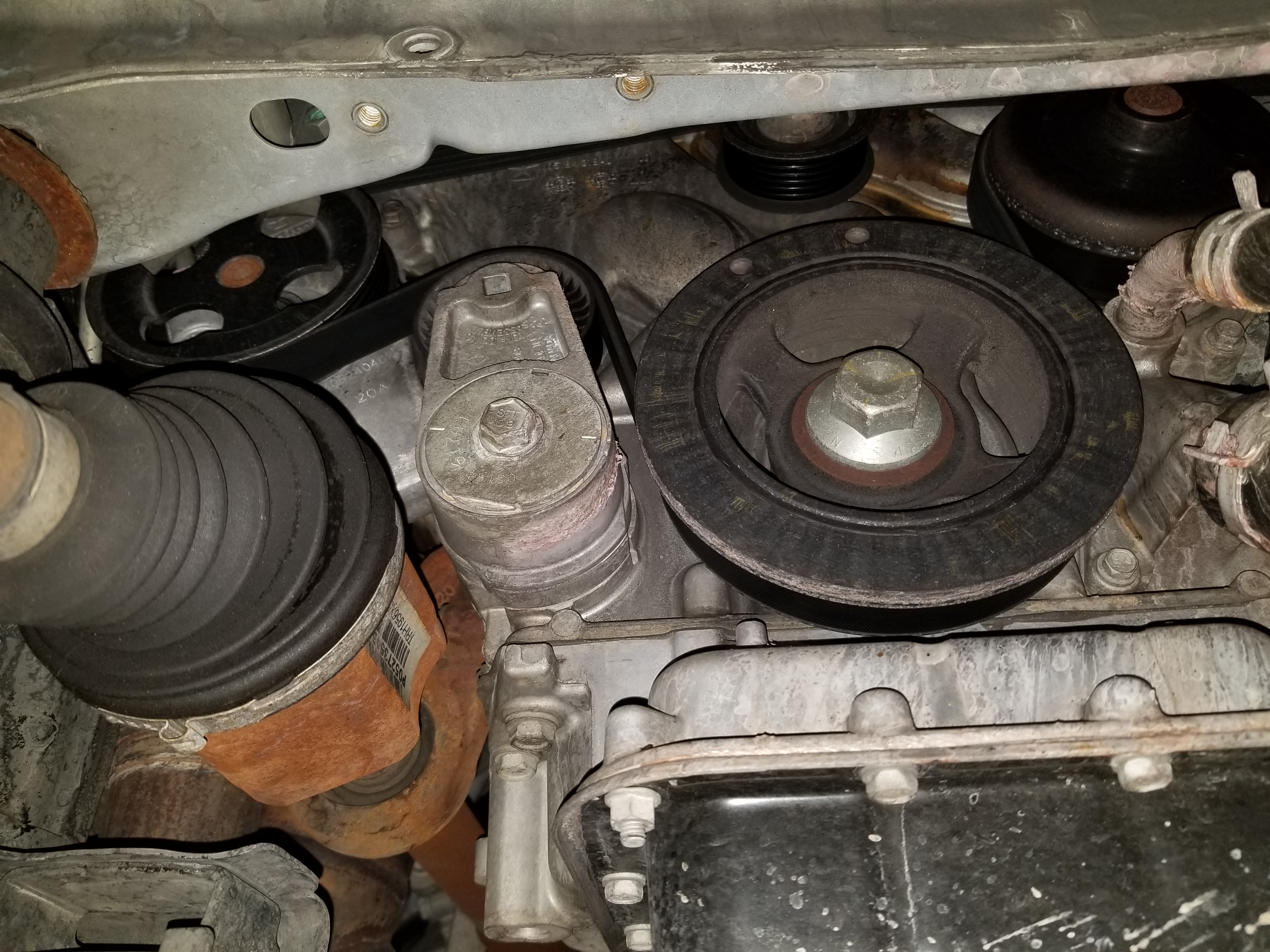

 Here's a pic of the belt tensioner. I don't believe before me, it's ever been used since this car came out of the factory.
Never heard of changing a perfectly good operating tensioner pulley just because your are changing the cerpintine belt .  You change that when or if  it ever starts making noise from bearing failure, easy change generally any way.  I hear what they are saying ( water pump when timing is done - yes ).  As you mentioned, where do you stop then ? Good luck with timing belt , water pump and belt change.
