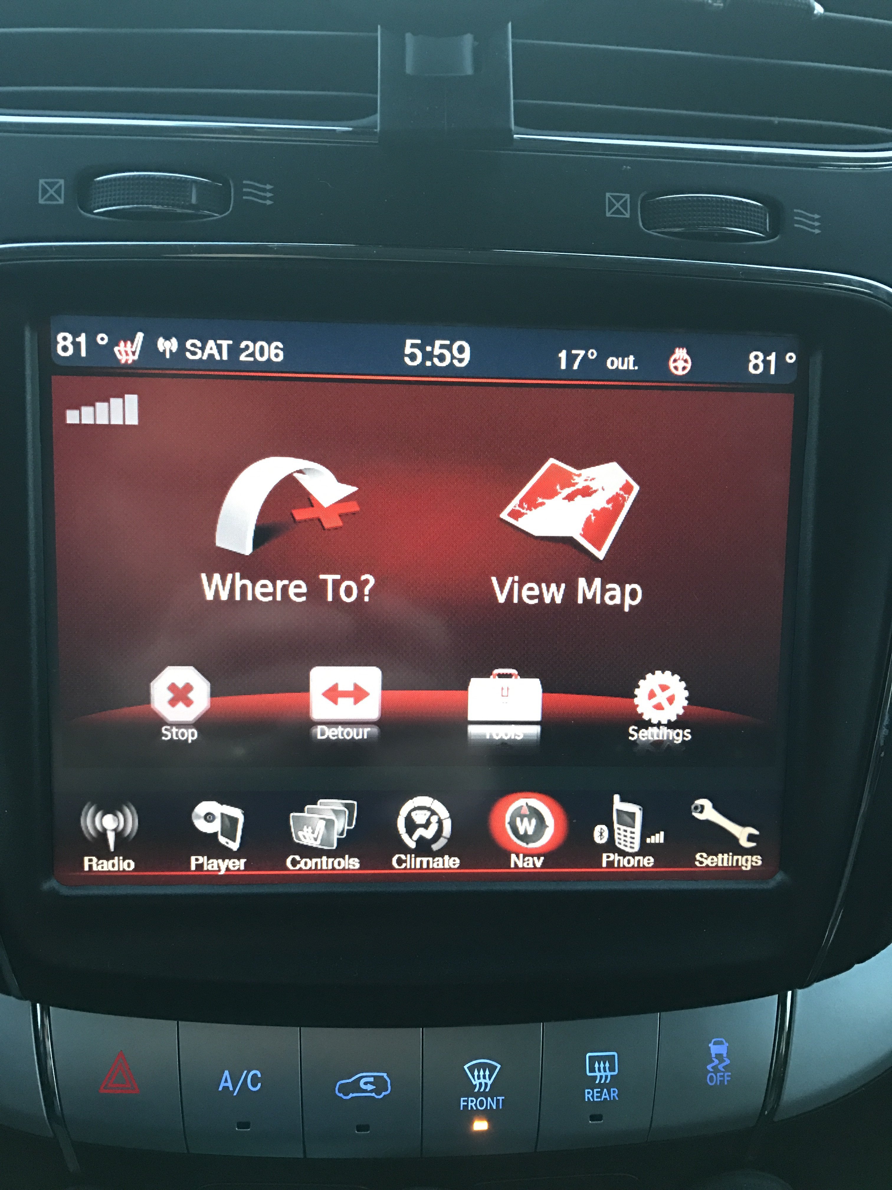

It says CTP15, the donor DJ was an Ohio car as what I was reading.  Here is what my radio screen looks like

Perhaps the '+' sign requires both a US country code AND a TraveLink subscription?  I know that my radio was subscribed to TL, but never displayed the option and I just assumed it was the country code.
As to the traffic circle, assuming that have a active traffic subscription, do you have traffic enabled in the relevant menu in the navigator?  If the feature is enabled then you likely do not have the subscription (or you don't have a 3rd generation radio, which is not the case if your navigator runs version CTP15).
I'm going to call Nav repair on Monday. they have an update that updates to the current rb5 software. I will see why ours has a settings icon and not a more icon. I just subscribed to traffic and travel link and the travel link isn't showing up.
