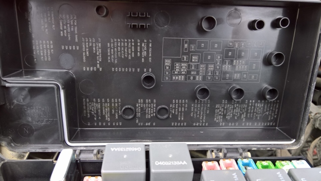

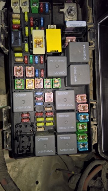

It looks like lock and unlock shares a fuse and its OK (fuse 38).

I tried shuffling around some relays to see if there was a chance that the problem would move around.  That didn't happen, the problem remained the same.  (I have no idea what else to try, so I was grasping at straws  :)  )
