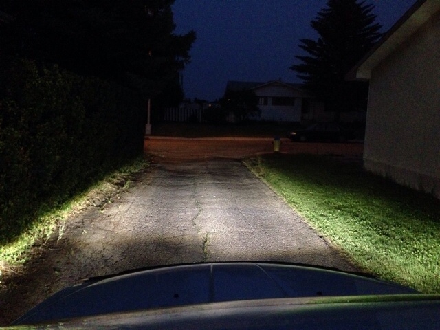

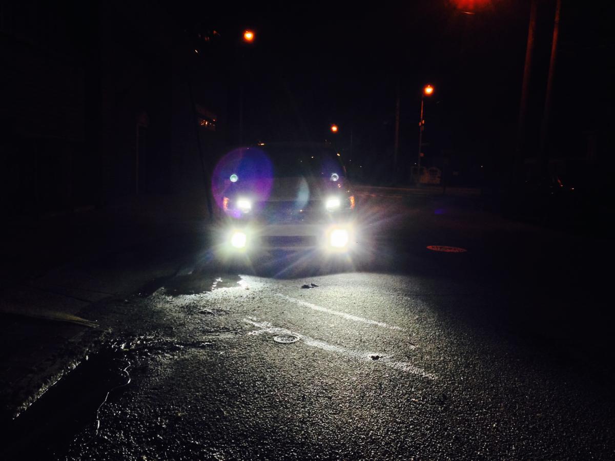

well here it is hid 6000 k with led fogs sorry i took so long

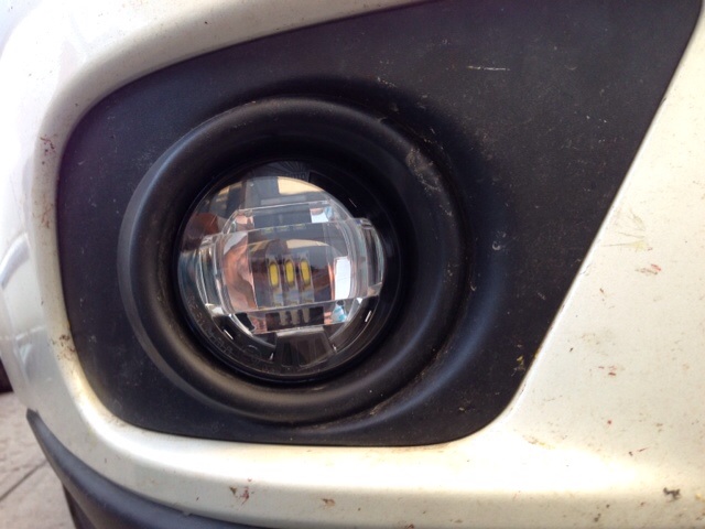

I just installed the new XB LED fog lights from TRS.
They turned out great, I'll be doing a how to in the next few weeks.
Here are a few pictures.
1st pic, how the XB LED fog light fits.
2nd pic, left side factory, right side New LED fog light.
3rd pic, Completed both LED fog lights.
