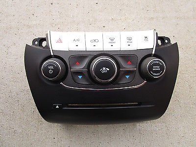

After reading all the thread, the climate control problems when upgrading from 4.3 to 8.4 are related to the Auto Climate feature.
If you don't have the Auto feature on your car, when upgrading to 8.4 you will face the described issue. (buttons on the bezel not working and when changing the temperature over the screen, it return to 22C)
How do you know if you have or not the Auto feature? Based on the climate bezel located below the screen.
I'm attaching some images so you can better understand.
Please see the central button. If you have it like the first image (only Off selection), means that your vehicle is not equipped with Auto Climate feature. If you have the second one, your car has Auto Climate support (in this case you can also have the splitted Off/Auto button without the SD hole/connector).
Said that...
Can anyone post the Part#  of the Temperature Control that we have to buy in order add the Auto Climate Feature to the vehicle?

There are only two bezels for 2011 through 2018 Journeys. What you need to buy and install is a temperature sensor if you want to be able to set the cabin temp to a certain degree, say 73f, and the vehicle will turn on heat or AC as needed. If you don't want that convenience you need to upgrade the vehicle's can system to use and see the auto movement on screen with an OBDGenie C-ACC unit from Infotainment.com. It's a one time use devise. As for me as long as everything works I won't spend $ 200 for it.
You need to do more then just add the temp sensor there are a total of 4 sensors plus wiring that is not installed in vehicles that do not have the auto climate (see my post a little ways back) plus you would need it flashed at the dealer...and we are not even sure the obdgenie will allow it to work without the sensors installed, all that might do is allow you to not have to go get it flashed at the dealer...other than that if your vehicle did not come with auto climate then the auto button wont do anything and when u use the on screen sliders the temp will always revert back to 22 but you should still feel the temp coming out of the vents change depending on if u use the sliders to make it hotter or colder

Yeah I'm sure they do show that but I have looked at extensive wiring diagrams on the tech connect website and it shows the temperature sensor wired in conjunction with the ambient light sensor the sun load sensor and one other sensor I can't think of off the top of my head right now in order for the auto climate to work how it should plus I don't know how you would add the temp sensor if the wiring wasn't there for it and I know for a fact it is not in the wiring harness for my wife's car I just added the  Uconnect hands-free Bluetooth to her car and none of that wiring was in her harness either I ended up buying a complete harness out of a 2016 Journey from a junkyard which had all the wiring I needed in it plus the wiring for the temp sensor and all other sensors I just don't know if I do even bother installing the wiring and sensors If the dealership would be able to still flash it or not
