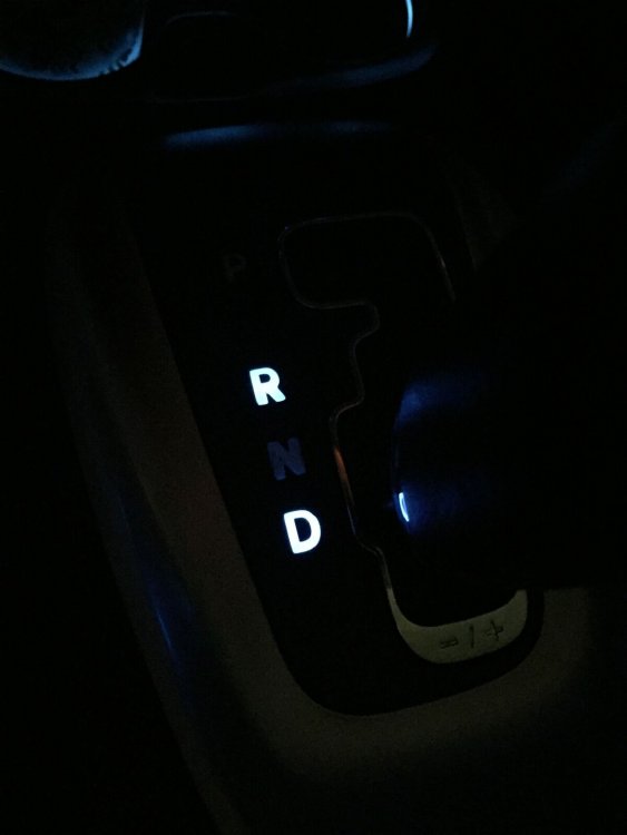

Gear Indicator Light Question
There's only one light for the transmission range indicator.  That you have two lights on indicates either the P and N are extraordinarily dirty, or there is something blocking them from underneath.  You'll need to disassemble the console to identify the root cause.
To remove the console cover:
Place shifter in Park
Disconnect negative battery cable
Remove shifter knob
Open the console lid
Remove coin holder and bin liner
Use a trim stick (plastic, don't use metal tools) to disconnect and remove the shifter bezel (extends up to the back of the console lid)
Remove the four bolts at the bottom of the console storage bin
Disconnect the wiring harness located near the shifter
Disconnect the USB harness located in front of the shifter
Remove the floor console
To remove/replace the light:
rotate the light socket 30 degrees counterclockwise and pull straight down
Installation of all is reverse of removal.
Given that you bought the vehicle a week ago, you could also ask the dealership to check it out for you.  That seems like it ought to be a basic safety issue.  For example, the Maryland safety inspection for sale/registration of a used vehicle requires that the gear range select indicator is accurate (PRND switch indicator properly shows what gear you have actually selected, and the transmission agrees with you).  I would argue that the ability to tell this in the dark is critical.  That means the light should work as designed.
